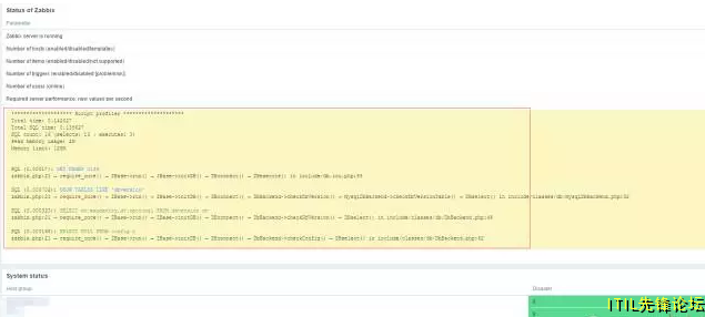

▲ 开启方法
Administration > User groups > 勾选Debug mode
打开之后在每个页面右下角会出现一个Debug
开启之后就可以看到每一个功能所执行的SQL语句

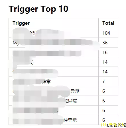

需求:每周告警TOP10
实现:查询Events,DEBUG模式查看SQL语句,筛选统计出前10
SQL = """SELECT count(distinct e.eventid) as cnt_event, h.host, t.description, t.priorityFROM events e, hosts h, triggers t, functions f, items iWHERE h.hostid = i.hostid and i.itemid = f.itemid and t.triggerid=f.triggerid and t.triggerid=e.objectidand t.priority > 3and e.clock > %s GROUP BY h.host,t.triggerid,t.description,t.expression,t.priorityORDER BY cnt_event desc, h.host, t.description, t.triggerid;""" % weektime
效果图:

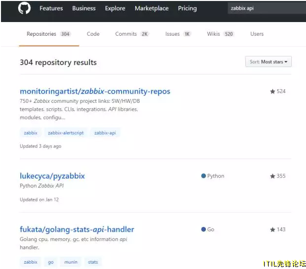

Github上也有许多优秀的现成框架:

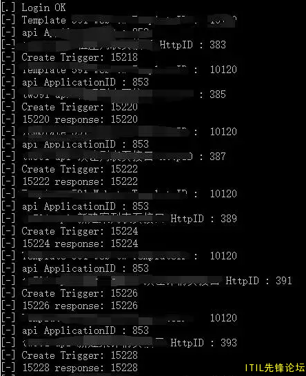

▲ 应用案例 2

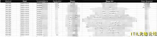

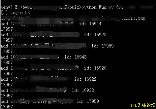

需求:批量添加web监控项
实现:把需要添加的信息填入excel或运维平台,通过读取信息请求API批量添加
# 读excel
import xlrdimport collections def ReadExcel(filename): Data = xlrd.open_workbook(filename) Table = Data.sheets()[0] Nrows = Table.nrows Ncols = Table.ncols DataList = [] Dict = collections.OrderedDict() for x in xrange(Nrows): if x == 0 : continue for y in xrange(Ncols): Dict = Table.cell_value(x,y) DataList.append(Dict) Dict = collections.OrderedDict() return DataList # 需求具体实现 def FastHttp(zabbix,TemplateName,Application,Name,StepUrl,StepsRequired,Denpen=None): HostID = zabbix.GetHostID("Zabbix Server") if zabbix.GetHostID("Zabbix Server") else False if not HostID:
print "No find Host" exit() TemplateID = zabbix.GetTemplate(TemplateName) if zabbix.GetTemplate(TemplateName) \
else zabbix.CreateTemplate(TemplateName,HostID)
print "[-] %s TemplateID : %s " % (TemplateName,TemplateID) ApplicationID = zabbix.GetApplication(TemplateID)[Application] if Application in zabbix.GetApplication(TemplateID).keys() \
else zabbix.CreateApplication(Application,TemplateID)
print "[-] %s ApplicationID : %s " % (Application,ApplicationID) httpID = zabbix.GetHttp(HostID)[Name] if Name in zabbix.GetHttp(HostID).keys() else \ zabbix.CreateHttp(TemplateID,name=Name,stepNo="1",stepName=Name,stepUrl=StepUrl,applicationid=ApplicationID, stepFollow_redirects="0",stepRequiredString=StepsRequired) print "[-] %s HttpID : %s " % (Name,httpID) TriggersName = u"%s监控异常" % Name TriggersExpression = u"{%s:web.test.fail[%s].sum(#3)}>2" % (TemplateName,Name) TriggersSeverity = "4" AllTrigger = zabbix.GetTrigger(TemplateID) TriggersID = ''
if TriggersName in AllTrigger.keys():
print "[!] Trigger already exists : %s" % TriggersName
else: TriggersID = zabbix.CreateTrigger(TriggersName,TriggersExpression,TriggersSeverity,StepUrl)
print "[-] Create Trigger: %s" % TriggersID
if Denpen: DenpenName = u"%s监控异常" % Denpen DenpenID = AllTrigger[DenpenName] CreateDepen = zabbix.TriggerAdddepen(TriggersID,DenpenID)
print "[-] %s response: %s" %(TriggersID,CreateDepen)
